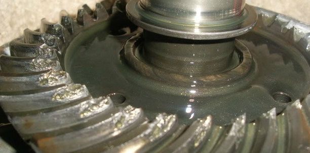

Posts: 5039
Re: /7 rear drive wear
This is what you don't want to see.
Play developed at the pinion gear bearing. It was asymptomatic. I found it at routine oil change.
