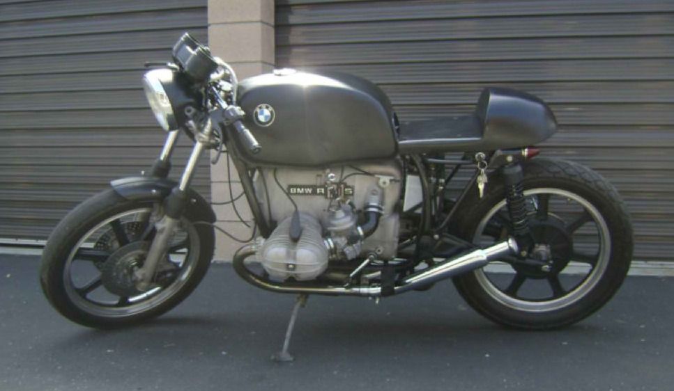

Here is a picture of the above bike. Remember: Seller admits no maintenance, currently Non Op with over $700. in DMV fees just to get it on the road. I think if you click on the picture you'll go to a small folder I made which has a few more detail pix.
-1977 R100S-
IF he pays the DMV fees does $2200 - $2400 seem reasonable to you more experienced folk? Or should I just walk away and wait for a better bike (maintained rather than neglected). Or should I start looking at later years? I find a lot of bikes for $3500-ish but they are newer with double or triple or 5x and 6x the mileage, etc.

You will be happy with an R100S
You don't want a mono by the sounds of your background and wishlist.
Save your money and buy a cared for example, even if miles are high it will be better and cheaper in the long run than a neglected example.

The only reason why I don't recommend a 77 (I have a 77RS and my buddy has a 77S) is the pistons are different than later years and I believe are difficult to find, if you need them. There is a flat band around the dome, where the later ones have the dome go to the edge. The head matches the pistons. So if you need 77 pistons, you may need to buy later ones and machine the piston crown to match the head. If you go to 78 or 79, I think it will meet your criteria without this issue. No big deal, but a consideration.

An unmolested 77 S would be a good buy, the 77s were by all accounts the fastest of the airhead range and the R100S was only produced in fairly small numbers.
It's a pity that the value of that bike has been reduced by all the work done to it, but the owner still wants to get some of his money back
