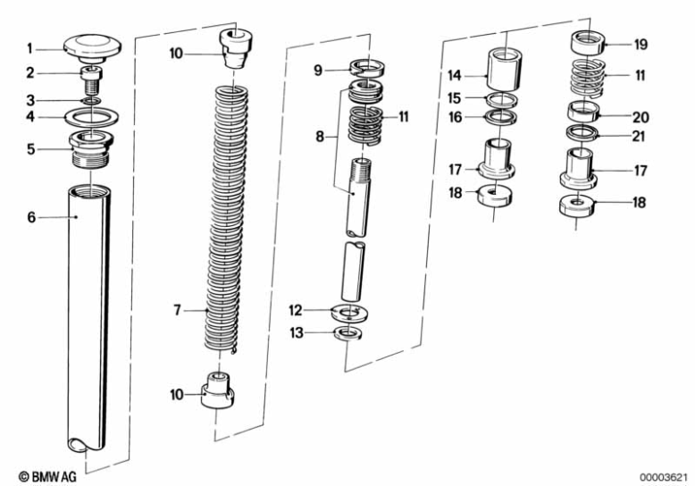

Re: 1982 R100 fork spacer dimensions
Which numbers? This diagram covers 9/80-11/82.
Part number 18 is the missing bottom spacers ring. The top spacer is not shown in this diagram, but is shown as part 12 on page 493 of my Clymer manual

From the BMW parts list...
Item 18 above - This part is not installed on the vehicle specified. I believe that item 24 on the Clymer diagram is actually the part numbered 9 on the BMW diagram above and is the part shown in image 156 in the Clymer manual.
Item 12 on Clymer - This part is a spacer ring to lift the front of the machine. It wasn't fitted to all models, mainly to those with full fairings to counter the weight of the plastic and restore the steering geometry. Also shown as 'This part is not installed on the vehicle specified'. Many riders fitted it to 'naked' machines in the belief that it would increase pre load... which it doesn't do, it just lifts the front of the machine (and incidentally, slightly reduces travel of the forks).
Hi Rob, thanks for your post. Part number 9 on the BMW diagram, variously called the piston ring or guide ring, is part number 17 in figure 150 page 493 of my Clymer manual (I appreciate it may be different in different editions). The part I'm looking for the dimensions of is definitely part 18 in the BMW diagram. Does the first statement of your post mean you have information to say it was never installed on my machine? Nice photos by the way. Tim
OK, it seems I've been somewhat barking up the wrong tree, but perhaps not without some reason: it seems that the bottom spacer was never fitted to my unfaired 1982 R100, but was only fitted to some RT and RS models. A huge thanks to Rob for pointing me in the direction of the excellent fiche diagrams and subsequent parts data on MaxBMW.com, I hadn't come across this excellent source of information before but had relied upon Realoem, who don't supply as much information. I'd assumed that if a part wasn't listed it was because it was unobtainable/no longer manufactured, whereas, as Rob pointed out, it means it wasn't fitted to that particular model. Now for the excuses! I was convinced the bottom spacer ring must be an essential part of the fork damper mechanism as I couldn't drain oil from my left fork after removing the drain screw because the damper rod support covered the drain hole. I couldn't see why BMW would provide a drain hole and then cover it. Yes, I did wiggle a wire up the hole to see if it was blocked with crud, but just met the solid resistance of the damper support. The witness marks on both damper supports confirm that they almost totally cover the drain holes; this is just weird. I can only assume a small piece of crud was blocking the hole and I failed to dislodge it, and there is JUST enough hole uncovered to facilitate oil draining - weird! I've only had my R100 for a couple of years and never owned a BMW before. Therefore I'm fairly new to these weird and ....., well, just weird motorcycles. Thanks again to Rob, and to Kurt for the info regarding the fork sag and top spacer. I can now confidently put the whole lot together again and get out while we still have some sunshine here in the UK.
