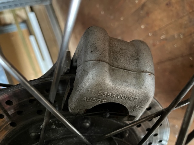

Nice! The brakes came from any twin disc Airhead from up to 1980. The calipers have either 38mm or 40mm pistons. If they're 40mm, they'll be stamped "40" in an obvious spot.

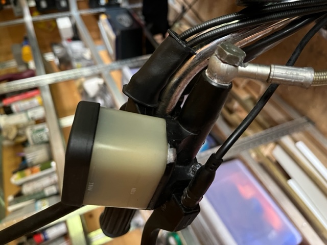

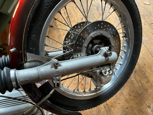

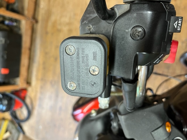

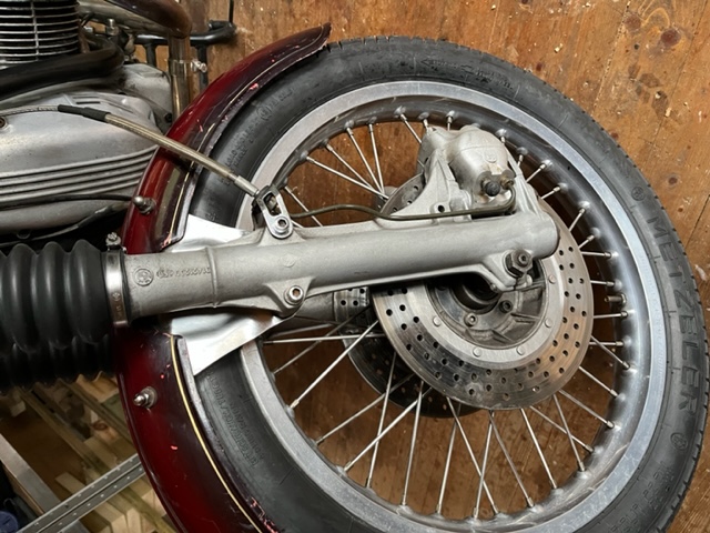

Interesting, - mine does have a master cylinder on the handle bar, it’s a UK supplied bike from the info on my logbook, mine looks exactly like like those photos ? - will check the back of the calliper for any numbers stamped. I have read a few articles about adjustment so when I get my new pads will follow them. Mine does look like original fit but who knows
Re: New Member R80/7 - 1978
Looks oem to me. Those discs look well worn though.
Even the handlebar stuff looks oem (from post 9/80 model). The size of it's master cylinder is stamped underneath. The SS hoses are aftermarket and a good addition.
