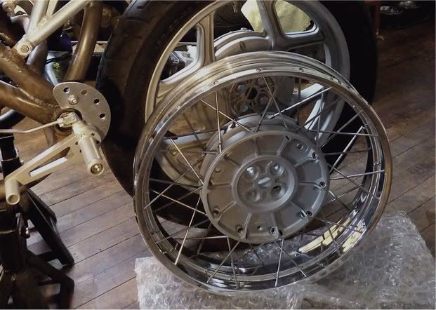

Hey! Can't see those wheel bolts!
The rest of it I just wasted.
wheel bolt update
I did purchase 4 BMW auto lug bolts.dougie wrote:Hey! Can't see those wheel bolts!
As it turns out, the cones, although the same taper,
are a slightly smaller diameter at the big end than those used on the BMW MC.
Consequently the over-all length will need to be shortened
by a couple of MMs in order to be used.
The rear wheel is currently on it's way to Denver.
When Woody's is done with their work and the wheel returns to the Schoolhouse,
the bolts will get the attention they need.

Re: Control - K.I.S.S. & the creative process
Nice wheel!
Are those tubles rims with the spokes on the outer lip?
Garnet
BMW/Akront tubeless 2.50-18" rim from the front of an R100R,Garnet wrote:...
Paralever hub from a GS machined to fit the mono FD ...
Woody's Wheel Works spoked them together with 8g SS spokes.

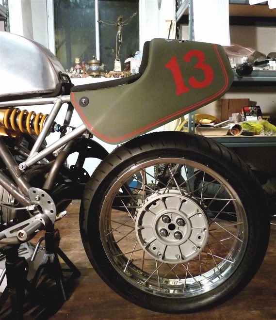

Lookin' good man!
Is that an Avon am26? Howza bout a rear pic?
Is it a 110/80/18? or 110/90/18?
Reckon I'll try an Avon am26 rear next. Few more dollars than my favourite Mac50 but thaere are no Macs left
I haven't found anything else that performs and wears as good as a Mac50.
Thanks, ME –ME 109 wrote:Lookin' good man!
Avon AM23 (race / non-D.O.T.) 130/65-18
