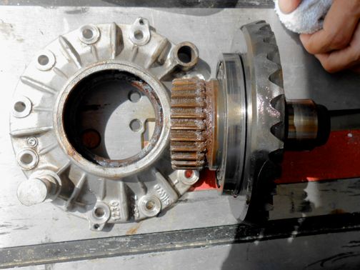

Spent several days assisting a friend in getting his new-to-him 1978 R100/7 ready for the road. Been in his garage going on three years -just sitting with old, cracked Metzlers. A cosmetic beauty but the surprises I found; just one of which is...
There was a wee bit of lash in the final drive. The crown gear/spline bit should be hitting Bud Provin's Nickwackett Garage any moment now. Surprisingly, the wheel's cup splines show barely any wear.

Re: /7 rear drive wear
Original wheel was probably tossed. Not everyone knows they can be re-splined, or a PO could have already had a spare wheel so saw no point in going to the trouble. I suppose it's also possible that the PO had the rear splines re-done, but, from that crown gear/spline, the PO does not appear to be one bent on going to a lot of trouble.montmil wrote:Surprisingly, the wheel's cup splines show barely any wear.
The photo wasn't made to show the ring gear, but it looks like it may have a broken off tooth.
