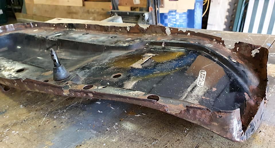

I know the old metal seat pans and cowls had a habit of rusting out something terrible, as I've seen them do it. Some say it was additionally provoked by gases leaking out of the lead acid batteries (I don't know that).
Did BMW, or some other third party supplier, change to fibreglass/GRP based replacements for both parts?
If so, who supplied the latter?
I've been looking at a few old 70s/80s era bikes and trying to work out what they are made of or whether they are original.
Thanks.
* (NB, not my saddle ...)
