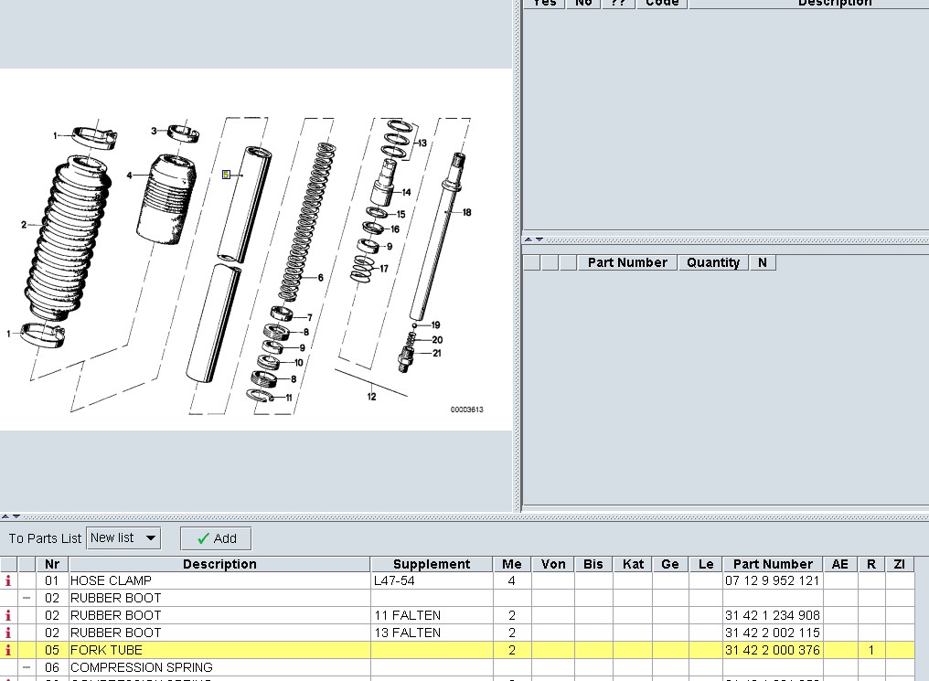

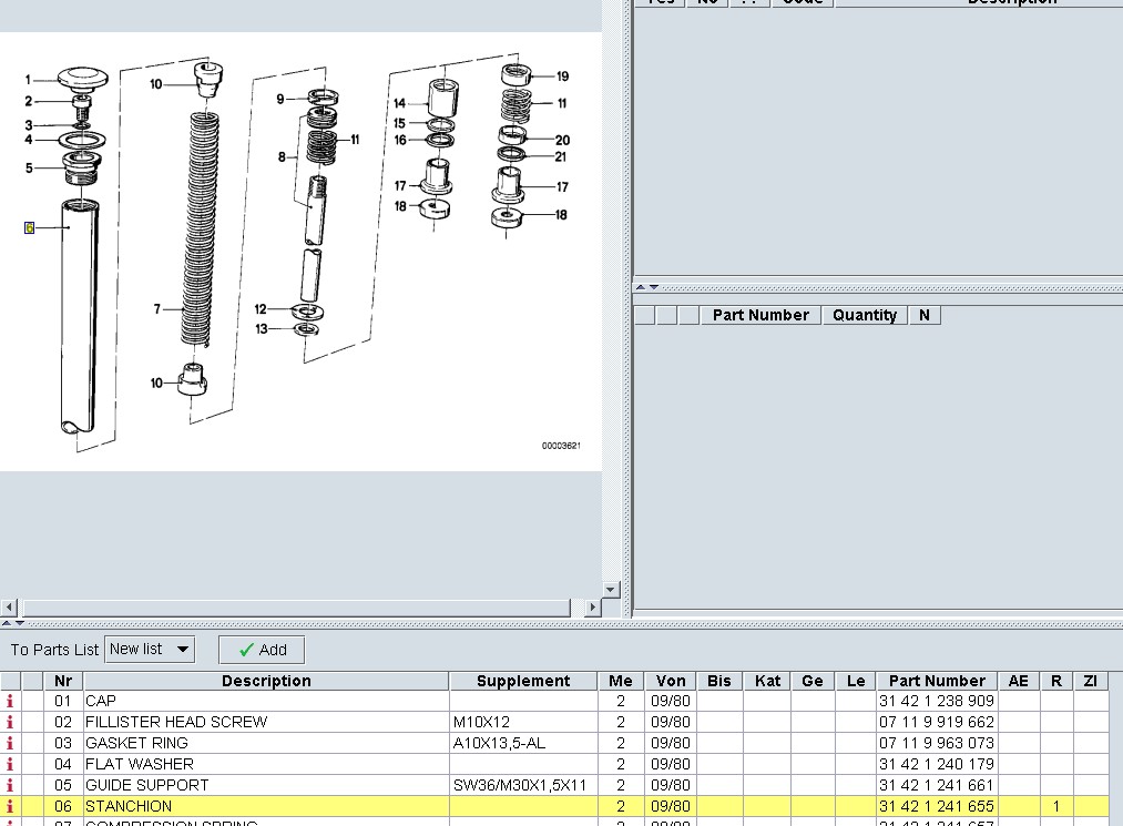

I'm sorry, I have to disagree. I think you're misreading the Parts Fiche. You need to look at the actual diagram for the vehicle concerned to get the full picture. Below are to images 'snipped' from the BMW ETK system which give the full story.
a) ATE Forks.jpg (135.21 KiB) Viewed 15386 times
a)Brembo forks.jpg (132.35 KiB) Viewed 15386 times
You will see that the first image shows the number as 31 42 2 000 376 clealy markes 'Bis 09/80' translated 'before 09/80'. The second image shows 31 42 1 241 655 clearly marked 'Von 09/80'. translated 'From 09/80'. You can also see that the internals are very very different and similarly marked as 'before' or 'after 09/80'. In addition, although they aren't shown in these diagrams, the attachment of the damper valve at the bottom of the slider is quite different.
I'm afraid I have to re-iterate that you can't simply put Brembo sliders onto the earlier stanchions.
