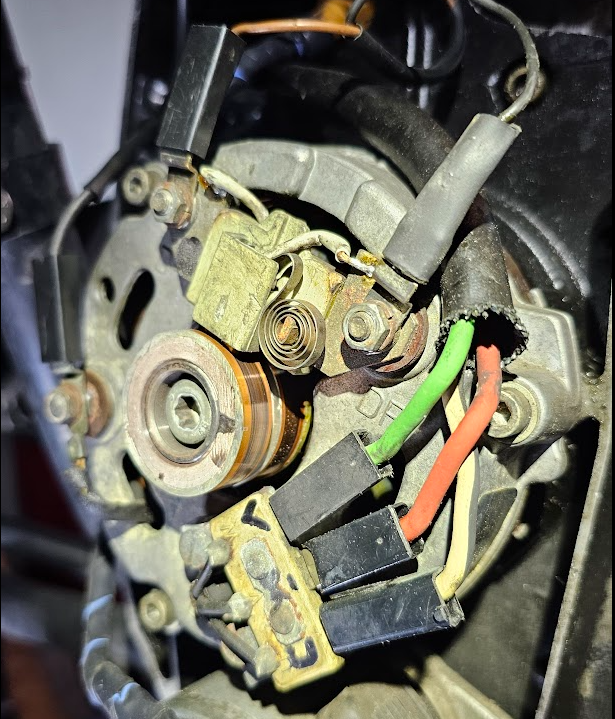

This is how the alternator part of the charging system looks right now
Screenshot from 2025-10-19 14-50-12.png (786.99 KiB) Viewed 7214 times
I have just unplugged the green, red-ish and white wires and hopped to measure some AC current from there. But nope.

Also, checked the brushes are touching and with enough length, and cleaned the rotor slidings.
Everything looks fine.

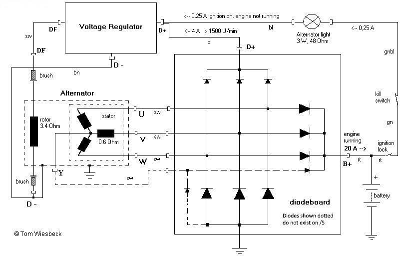

Re: Got a "tiny" charging problem...
The stator won't produce any output until you get some current flowing through the rotor. It sounds like that isn't happening initially because of a break in the wiring somewhere. It might help to break things down into sections. For example, using the diagram above take a temporary feed from the battery +ve to the green blue side of the charge lamp. If it lights up by being earthed via the regulator and rotor you will know that side of the circuit is OK and you can then trace back in the other direction to find the break.
