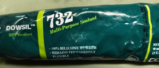

I've used Dowsil 732 with success on glass and 'eyebrows' on the instrument cluster. Stays flexible so not permanent.
Dowsil 732.jpg (35.88 KiB) Viewed 37801 times

Thanks both, I've a tube of silicone somewhere I'll dig out.

Glued them on with a multipurpose silicone goo I've had in the freezer for ever...let's see how long they stay put!
