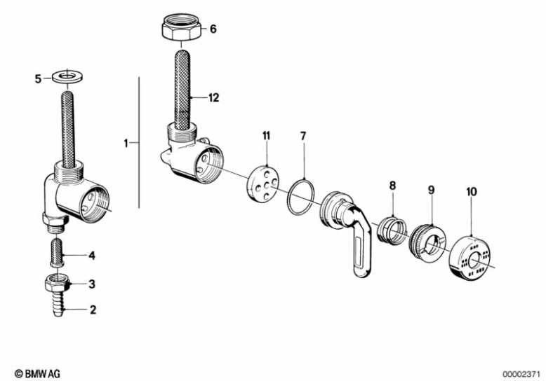

What colour was the junk in the bowls? Red is tank lining, black is fuel hose. Looks like Karcoma taps. There should be an in tank filter sock over the inlets and an inline small filter in the fuel tap itself. It'd be worth emptying the tank, removing the taps and having a good look. Then you'll know they're good or not. # 4 & #12. If you loosen/remove #3 you'll be able to drop the small filter to check it. #12 needs the tap out.
