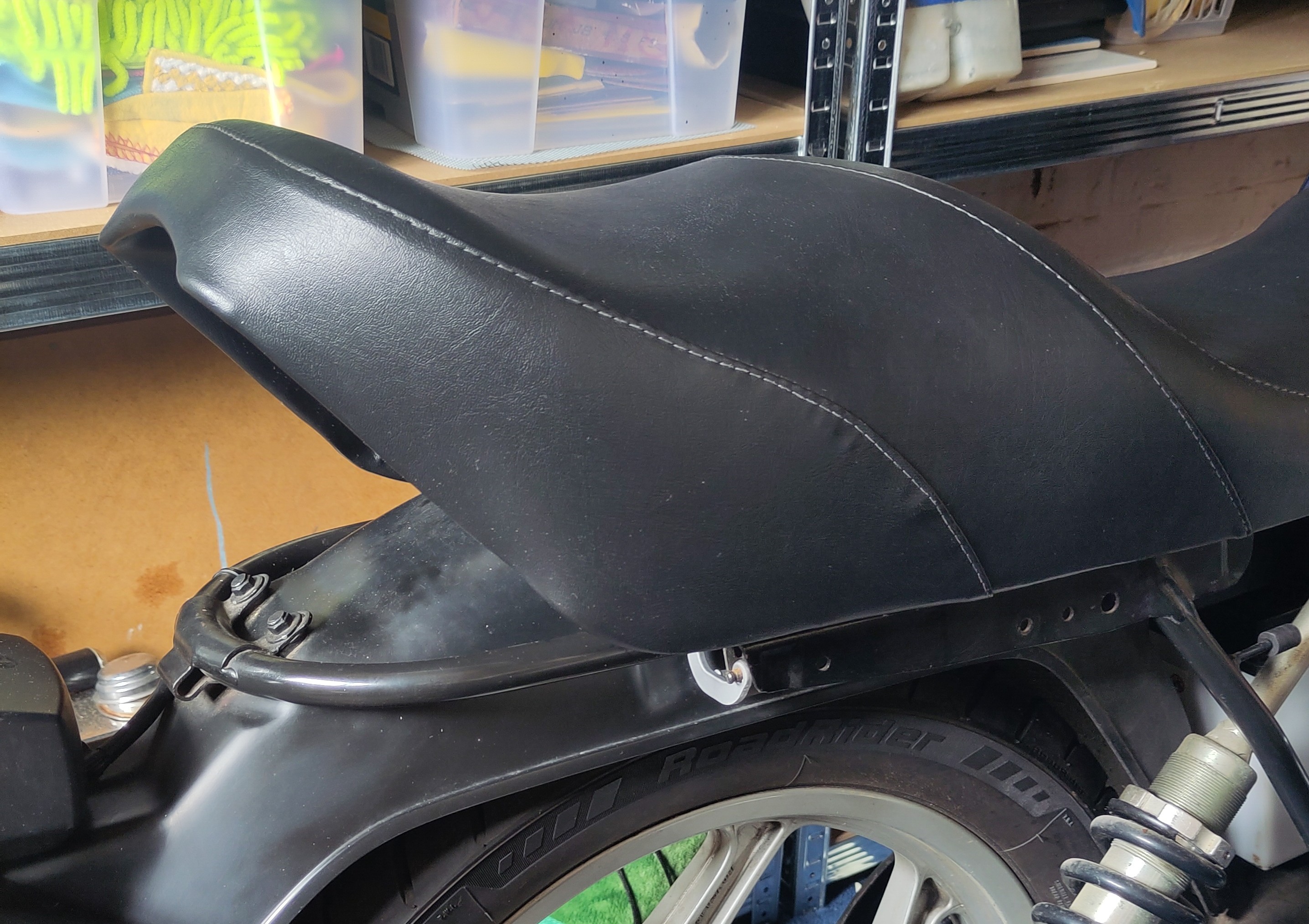

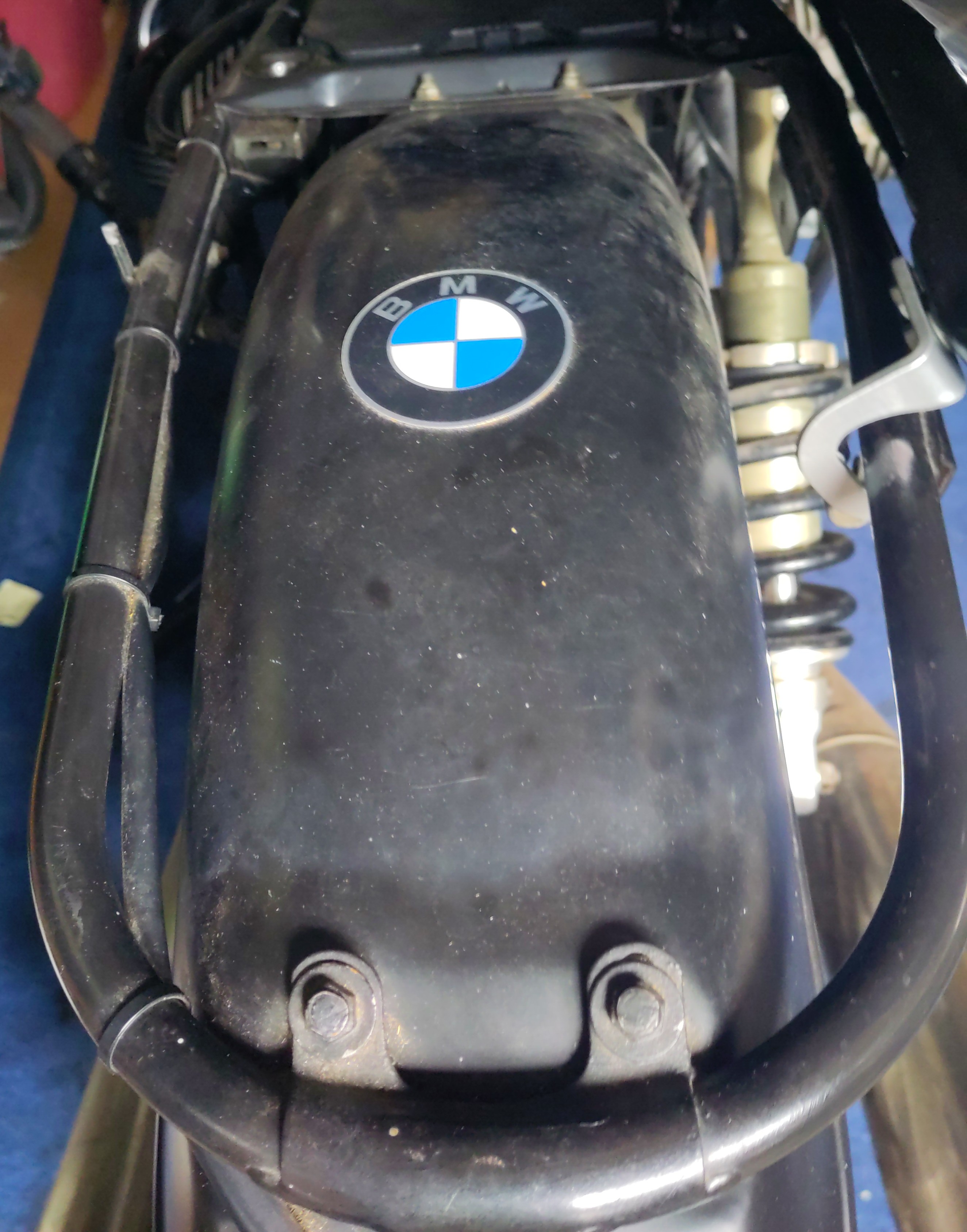

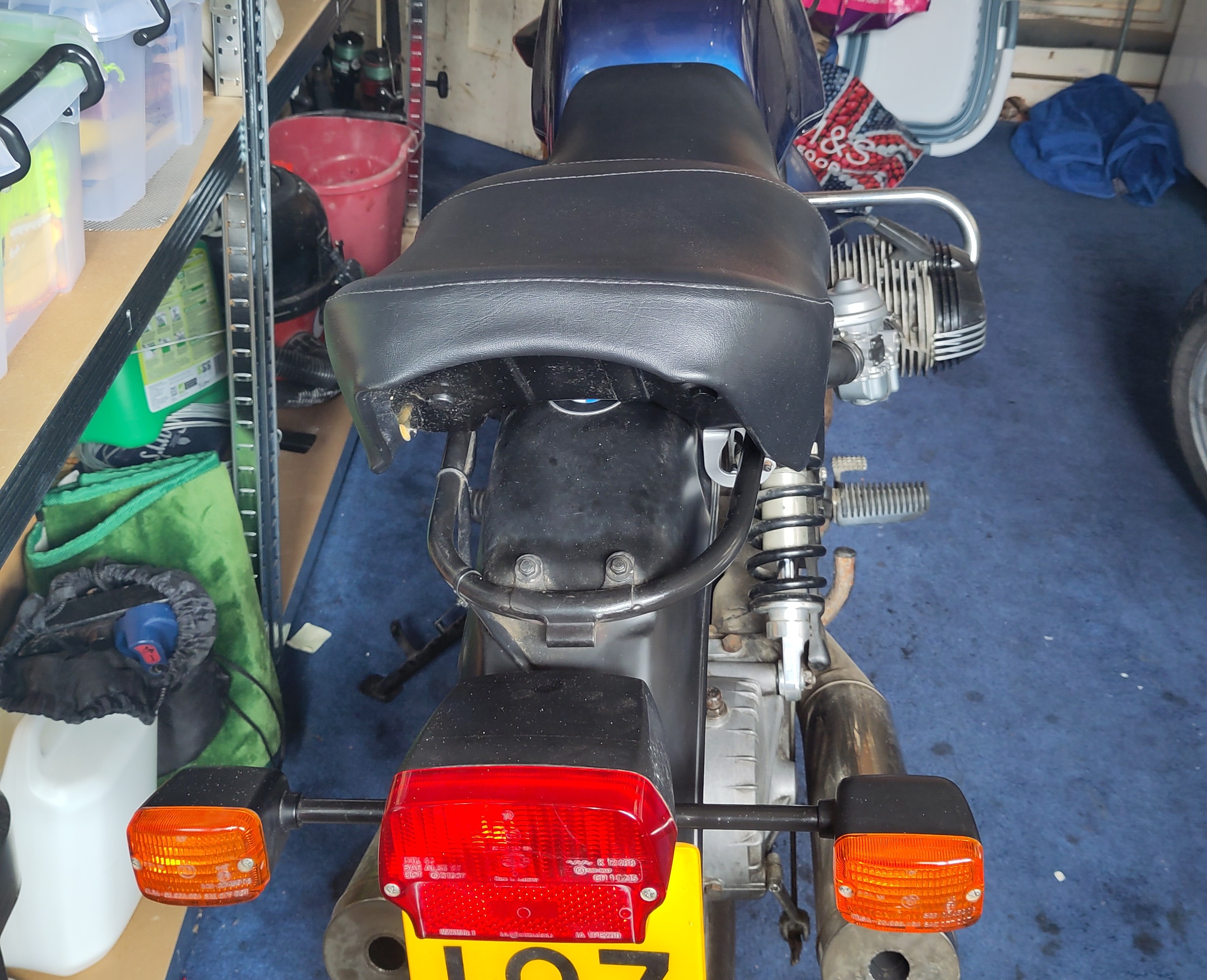

I'm recommissioning the above bike which was converted to a single seat by the previous owner. I want to convert it back to dual seat and have purchased an aftermarket one which I suspect is a bit different to the original since clearly it needs a rear cowl. Looking online it seems there are quite a variety of cowls available and I don't want to get the wrong one. Any guidance would be appreciated, please refer to the attached photos.

The 'perhaps not so good news' is that I can't be sure that the stock cowl will fit with your aftermarket seat... my impression from the image is that the rear of the seat may be too high to match. It might be worth contacting the makers of the seat for advice... unless, of course, you can find someone who has the same seat or someone who will take the cowl from their bike and let you try it...

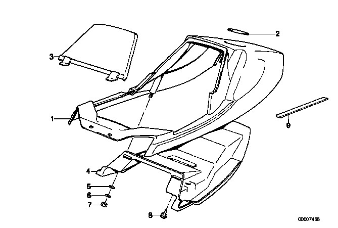

Incidentally, the cowl consists a number of parts as in the diagram below...

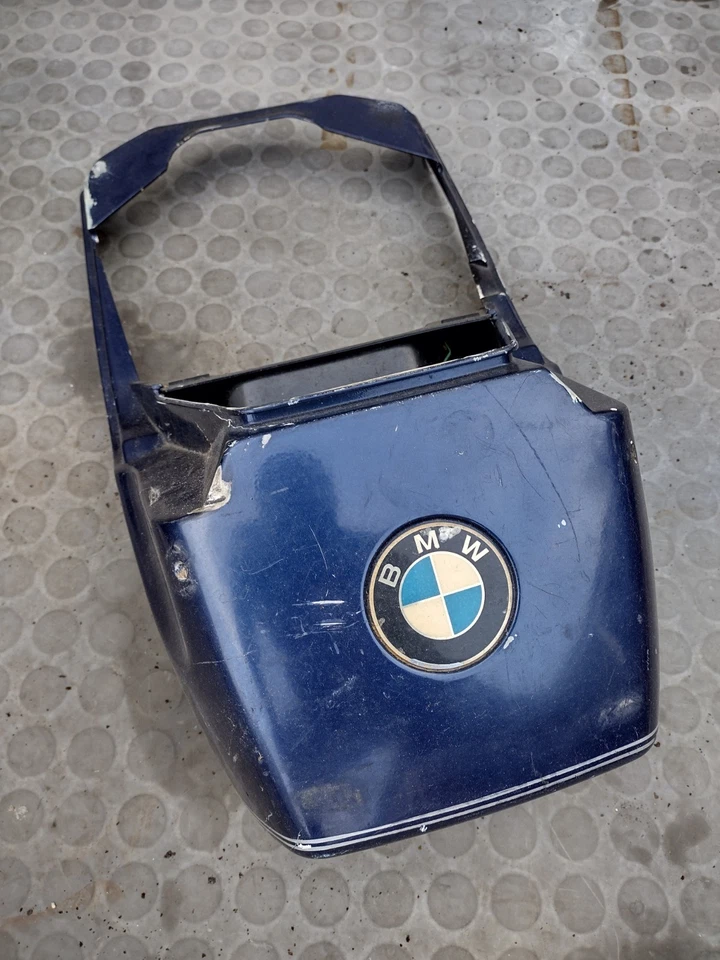

Having seen a few pictures of R80s online the cowl top seems very square whereas the seat I've got looks like it has a cut-out for a more rounded shape.
Here is an example for sale on ebay
https://i.ebayimg.com/images/g/IO0AAeSw ... -l960.webp
I will try contacting the seat seller as you suggest.
