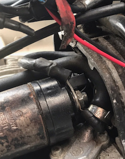

Much against my better judgement, which is “if it ain’t broke don’t fix it” I removed the Bosch starter motor over the winter break to give it a clean / overhaul. This was mainly a good clean up following disassembly as brushes still had plenty of wear left. Front cover was removed to access starter retaining bolt.
Bench tested starter before replacing, all ok. All back together and all functioning as per normal. Starter operates fine, all lights ,indicators and instrument lights working as normal.
However, both the negative and positive main battery cables are getting VERY hot even when not operating starter, i.e. even if ignition off and no attempt made to start, the battery positive and negative cables are getting hot, so much so insulation is on point of melting! Suggestions much appreciated.

You have a direct short to ground somewhere, disconnect the battery immediately!!
Check the battery to starter (thick) wire and the smaller one from the starter to the diode board. One or the other could be pinched under the starter cover or front cover. If you disconnect the battery negative cable and put a test light between the cable and battery terminal, the light should not go on at all. Disconnect the clock (if you have one) for this test.

Problem solved, thanks for the advice.

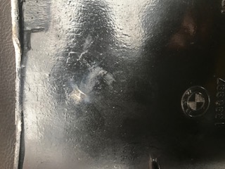

As you both said relatively easy to track down the short. Issue caused by badly routed starter cable, with cracked insulation which was touching the inside of the starter engine cover. Slight burn mark on the inside of cover provided the evidence.
Doug
