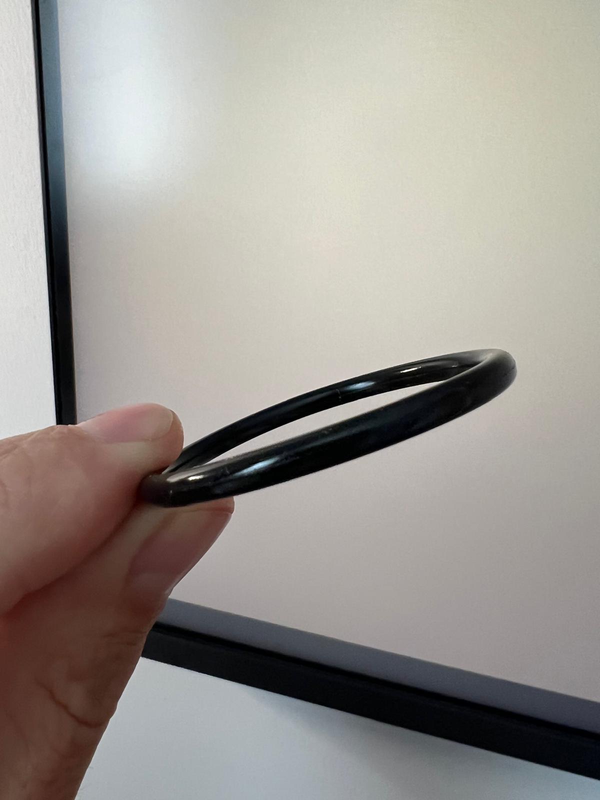

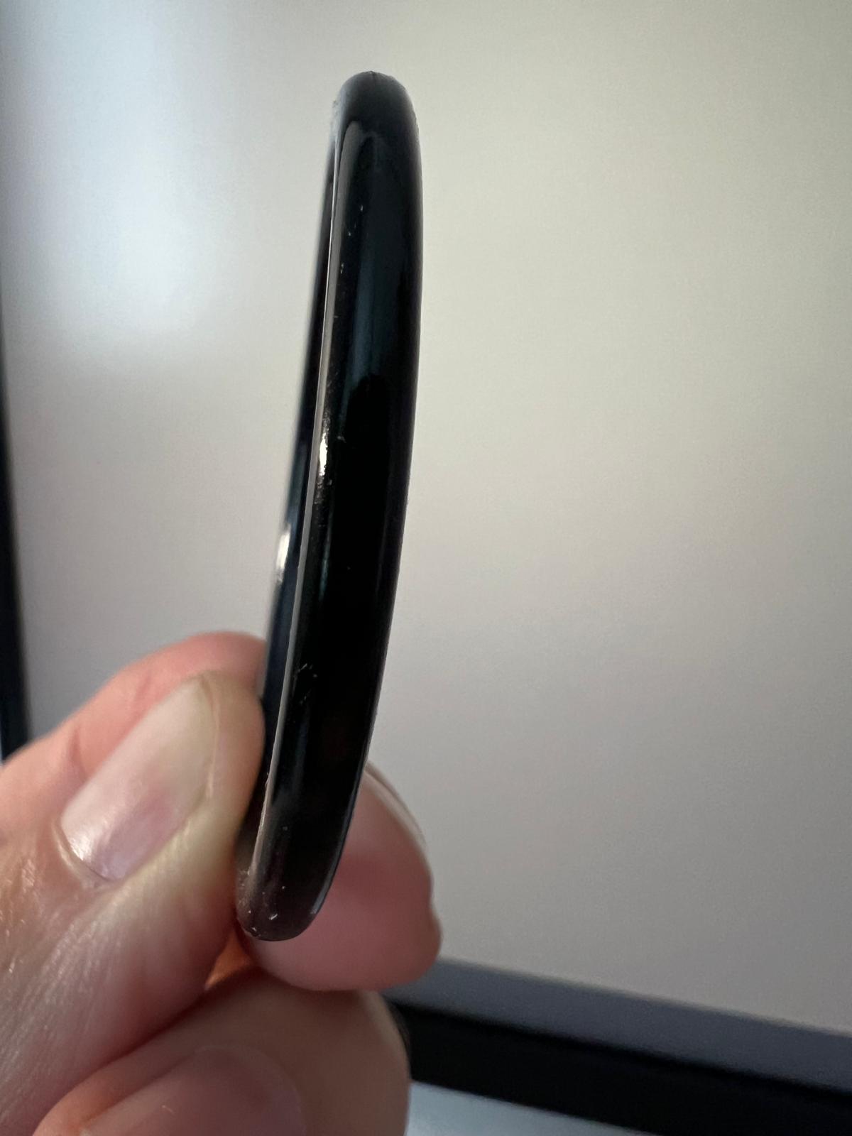

Good morning, thank you for your continued input.
Please see the attached image of the cannister appears to suggest two things. No shim is currently installed and the canister is not the sharp edged version.
I have also taken images of the O ring which appears to be as new. I could potentially replace this however (and the filter) as I have a replacement in my possession.

- oring2.jpg (89.88 KiB) Viewed 4424 times
- oring1.jpg (87.07 KiB) Viewed 4424 times

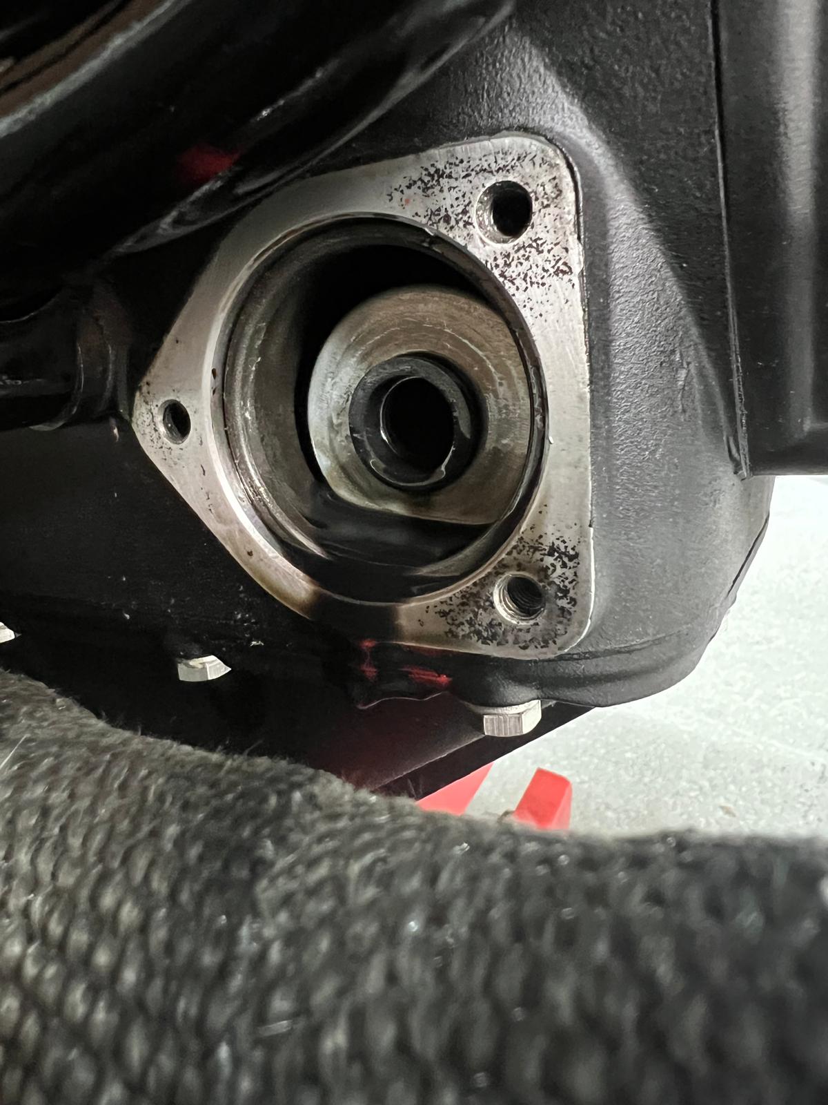

Could it be that what looks like pitting on the engine case is causing the leak?

A 1990 engine shouldn't have a shim fitted! The end of the filter can is swaged over.It also should not have a gasket. The only sealing item in these late engines is the 'O' ring. Always source an OEM 'O' ring or one that is GUARANTEEED to have the same characteristics (some vendors supply ordinary nitrile rings which are not really suitable). OEM rings are white and are a lot softer than stock black nitrile rings.

A useful observation, thank you. I just checked and the black appears to be residue left by the gasket. I shall remove it all before I put the cover back on.

Thank you for your comment. My bike appears to not have a shim fitted. I am in receipt of a MAHLE OX 36 D filter which comes with the white O ring that you mentioned.Rob Frankham wrote: ↑Wed Jun 19, 2024 6:03 am A 1990 engine shouldn't have a shim fitted! The end of the filter can is swaged over.It also should not have a gasket. The only sealing item in these late engines is the 'O' ring. Always source an OEM 'O' ring or one that is GUARANTEEED to have the same characteristics (some vendors supply ordinary nitrile rings which are not really suitable). OEM rings are white and are a lot softer than stock black nitrile rings.
It appears to me that my bike was fitted with a gasket because a black O ring was fitted at the same time.

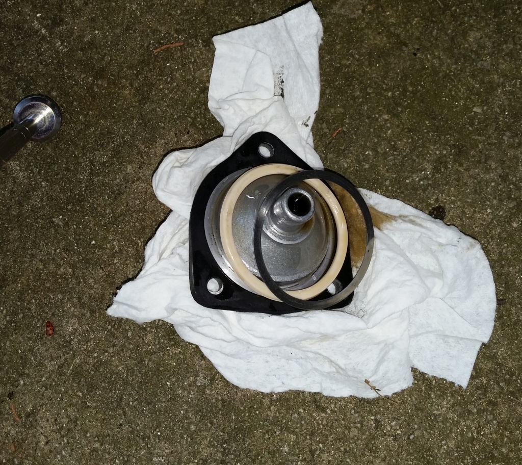

Nice eyes seeing the thin metal shim in the wrong place. The outer edge of the canister was remade at some point and rather than being a straight cut edge, the edge was rolled. Technically it might not need the metal shim, but that rubber washer is important for sealing. The shim may also be needed to create the proper squish on the o-ring.
If the o-ring looks perfectly round, then it's pointing to the fact that the setup in your bike is not correct. Without proper pressure on that o-ring, oil can bypass the filter and go straight to the sump or at its worst, reduce the oil pressure inside the engine.
This is what the parts look like coming out of my /7. Note I'm using a gasket in order to adjust the squish on the o-ring.

That o-ring isn't compressed at all and should be after a few 1000miles.
I thought that was a shim under the black o-ring in your pic
