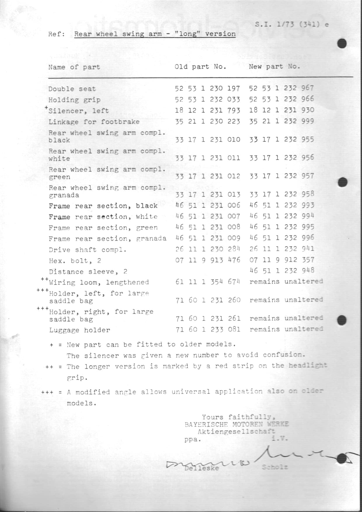

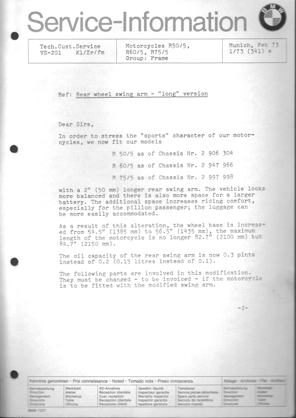

The attached BMW service bulletin from January 1973 might be of interest...
It shows the parts necessary to convert short to long wheelbase and confirms that the rear subframe is, indeed, different...
long swinging arm_1.jpg (139.28 KiB) Viewed 2088 times
long swinging arm_2.jpg (145.74 KiB) Viewed 2088 times
