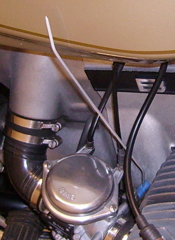

When the carbs have been set up and adjusted correctly there should always be some slack in the throttle cable but not too much or the throttle will feel sloppy with too much dead movement before the revs rise. BMW specify 0.5 - 1mm. O.5 mm is probably too ambitious and most people will aim for 1 - 2mm. I'm still not convinced that the OP has that slack after reading the original post again.
Generally most descriptions for adjusting the carbs will recommend more initial slack than 0.5 - 1mm to ensure that the cables cannot possibly have an impact on the idle settings. Once the idle has been set to the correct speed the amount of slack should then be reduced to the chosen amount and the carbs balanced to ensure both butterflies begin to open at the same time. Several ways of doing that either mechanically or by vacuum measurement. As it happens I've recently done mine after cleaning and greasing the throttle gears and chain pull which should be done every 5000 miles. The mechanical method I use is to push fit a short rubber sleeve (blue) onto the inside of the butterfly shaft and pierce that with a light weight knitting needle. With these indicators on both carbs amplifying the rotation of the butterfly shaft, I sit astride the bike and open the throttle very slowly to see which indicator twitches first then adjust the cables to get them both moving at the same time. It's a very sensitive method and quite good enough if you don't have a manometer. If you do have a manometer then a follow up check of the vacuum signals will usually shows the balance is near enough spot on.
If using only the vacuum method you just need to be careful the balance is not too far out initially or there is a risk of pulling the indicating fluid into one of the carbs. With the manometer showing a balance at idle, the throttle is opened slowly and the two columns on the manometer should stay balanced if the cables are correctly adjusted. Generally one column will rise slowly and the other fall. You then adjust only one of the cables to bring the vacuum into balance and finally check there is still some free play in both cables with the throttle closed.
