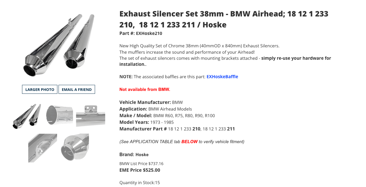

Airheads are usually quite muffled. But the boxer engine can really sound beautiful with the right exhaust, and it doesn't have to be loud.
I've been thinking of a set like this.
Screen Shot 2023-07-03 at 10.00.17 AM copy.png (206.82 KiB) Viewed 2732 times
