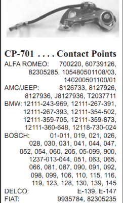

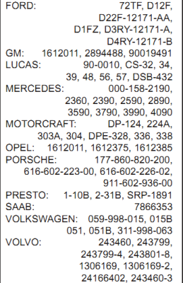

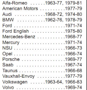

For those with points in a can there are allegedly many alternatives available which is perhaps not so surprising given the can was developed from an existing automotive distributor. Here is what is supposed to fit.

Re: Norris points
This is becoming a common issue for any engine with contact points, I work in a polytechnic in the Automotive training department and we have engines in frames for practical basic tuning training, all have contact points and we are finding getting parts like contact points rotor arms and caps harder to obtain.
I have just cleaned out our local supplier of spares for these items for our engines, and yes the copy parts made in china are frankly rubbish.
