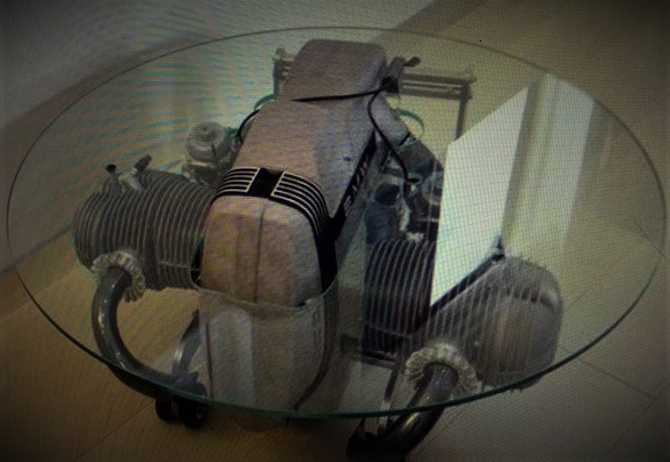

Bugger, it looks kaput. I won't link to the crank regrind thread. ;)
There is an option or two...
coffee table.jpg (477.1 KiB) Viewed 947 times
