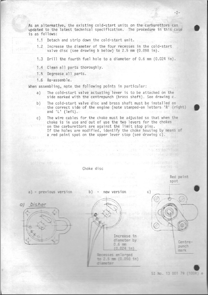

Here are three BMW Service Bulletins that might be of assistance (or at least interest)...
Irritatingly, can only post three images per page and each image is two pages so the final three are on the next post...

Re: carb adjustments
That choke mod is specific to early R45/R65's. I've done it to mine and it transformed the choke operation to something that actually works progressively. I would highly recommend it for applicable bikes. I suspect enlarging the counter bores is as much to do with the positive results as drilling the 4th hole. Prior to the mod I had the distinct impression that it was possible for the disk to end up in between fuel holes and do nothing which the larger counter bores resolved. It's easy enough to do although you will have to find something that will hold a 0.6 mm drill bit which is a lot smaller than you might imagine. On the basis that drill bits can have a tendency to produce an oversize hole I drilled mine 0.5 mm and then checked it with the 0.6 mm bit.
There may have been another bulletin later to specifically cover other models, but the one posted here by Rob covered all models. I'm not 100% sure about this but I believe that sometime in the early to mid '80's this mod was done by BING (or BMW) during production and all new bikes had the enlarged holes rendering that bulletin obsolete for later bikes. There were no r45's sold in North America, and not that many r65's either (compared to other models).
I've never had any reason to check the size of my PD's choke holes to see if they were actually factory enlarged.

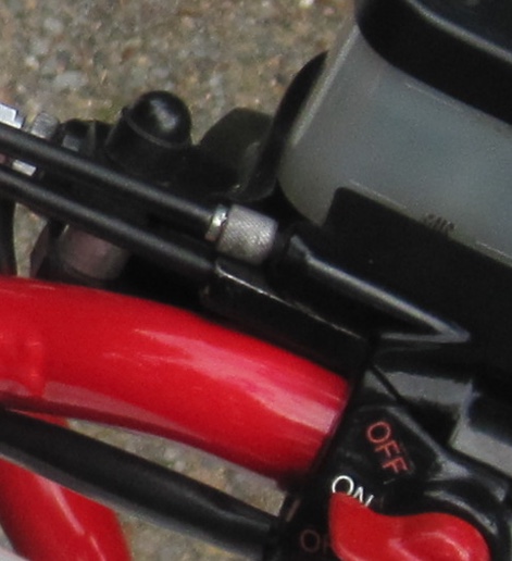

I have a custom made adjuster at the throttle so I can fiddle with it anytime, just to keep it finely tuned. You only need to adjust one cable to sync two carbs. A quarter turn either way makes a huge difference at just off idle because the butterfly is barely open to begin with. Once rolling down the road, a full turn either way makes no noticeable difference because the butterflies are way more open.
- syncher.jpeg (65.19 KiB) Viewed 975 times
