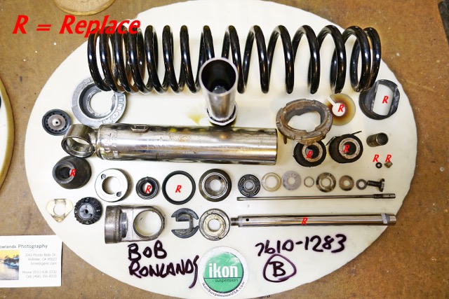

So I've got 65,000 klms on my shocks. I sent a note to Ikon in the States (Pa) Here's what they sent.
Fair Dinkhum? :geek:
Rowlands B.jpeg (103.52 KiB) Viewed 6700 times
Thank you for your inquiry regarding service to your Ikon 7610 Series suspension units.
Assuming it's just a regular service replacing seals, 'O' rings, fluid, upper and lower mounting bushes and labor, the price is $110 per shock = $220 plus insured return USPS shipping to US addresses $25 TOTAL: $245 USD
If additional parts outside normal service are required, such as replacement springs or piston rods etc. that is an additional charge.
Please securely pack, insure and send the shocks to us at the address in the footer. Upon receipt, they are stripped (see pic) cleaned and inspected. Pics and a condition report is then emailed to you along with price for service.
If you agree, an invoice is emailed to you for secure online payment and we generally have a turn around time of 5 working days or sooner plus return shipping time.
Please include a piece of paper in the package with your name and return address.
If you have any questions I'll be pleased to assist.
