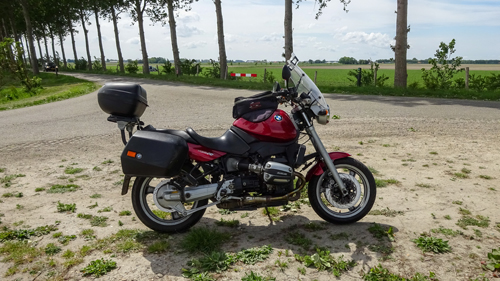

I have a BMW R850R from 1995 and recently I bought a Givi monokey rack and a big Givi topcase.
On previous bikes, i always had a topcase and never had a problem but with this topcase on this BMW makes the bike feel unstable.
Is it me or is this a common problem and how do I solve it ?

I've had a big Givi on my 1991 K75 standard for years never had a problem what type windscreen do you have? steering bearings good? tire press ok

I have the original BMW windscreen, bearings are good, tires are rather new and tire pressure is checked.

Is your topcase overloaded?

just to check you might take the case off and see if the problem goes away. maybe check it with a lite load ect
Re: R850R Topcase problem
One thing worth thinking about is whether the top box is making an existent problem worse. If the machine has an tendency to be a bit unstable, then putting weight in that sort of place can often make something that is normally undetectable, worse. While I'm not a fan of top boxes (I can't really think of a much worse place to add weight to a two wheeled vehicle then high up and overhanging the rear of the combined contact patch), I would be inclined to check all of the other causes of instability before 'junking the trunk'.
Steering head bearings, swing arm bearings, wheel bearings, shock absorbers, wheels, tyres, tyre pressures & etc. etc.

Wookie: No, loaded (not very heavy) or unloaded, the same problem
richard t: Without the topcase it is a perfect bike, no problem at all.
Rob Frankham: I only have a problem with the topbox and not without. I never have a very heavy loaded topbox. The main function for me is a place to store my helmet and satnav when parked and my camerabag and some small items when riding.

Just because you've never had a problem, doesn't mean there isn't a problem. It might have just needed the top box to push it over the edge to instability. In fact, of course, that's just exactly what's happened. Fitting the box has pushed a normally stable bike over the edge. The question is whether there is something not quite right about the bike in the first place that made it happen. I would still be checking all of the things I mentioned.

I bought a smaller topcase and the problems are gone.
