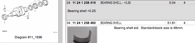

I worked as a mech for 49 years, I've never seen anybody sell 1/2 half of a bearing, that like selling each shoe by itself
Re: Parts sourcing - Top-End Rebuild?
richard t wrote: Tue Jul 12, 2022 12:05 am I worked as a mech for 49 years, I've never seen anybody sell 1/2 half of a bearing, that like selling each shoe by itself
Most manufacturers do sell them in pairs.
BMW sells them individually, not sure why.
half a bearing.jpeg (30.11 KiB) Viewed 1960 times
