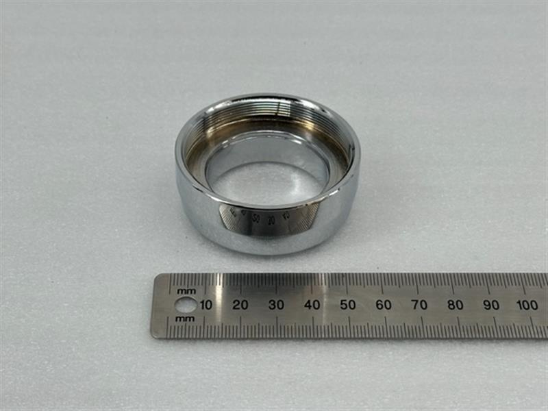

What's the deal with the "knurled nut" .. photos show they are internally threaded, but the front hub is not. Are there just smooth, press fit ones for the 2/3 rib hubs? (I see the 4 rib hubs have threads on them).

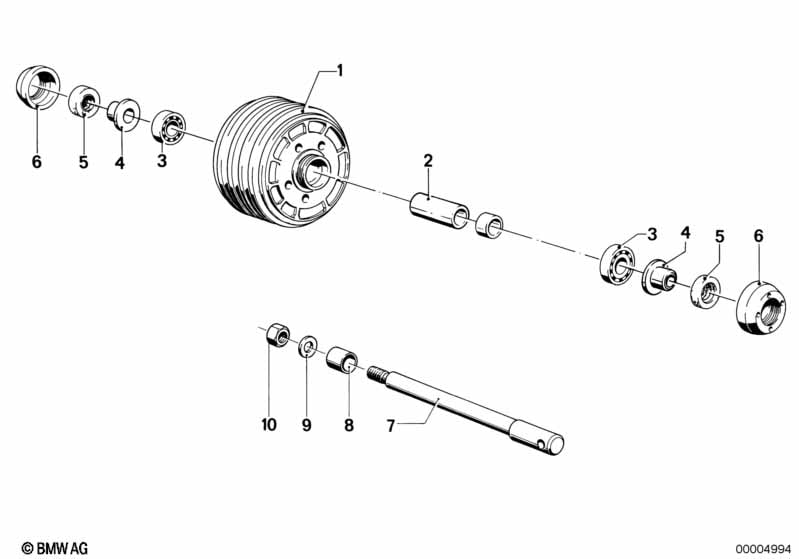

barryh wrote: Sun Mar 22, 2026 5:30 amI'm not familiar with the spoked wheels in any great detail. It might be best to identify the part by posting a parts fiche diagram.
What they call the "knurled nuts" (KN) are really just chrome caps that fit on the outside of the dust seal in hub. The drawings show them ... but don't show different hubs. On some hubs the boss (?) that holds the bearing and seal is threaded, as is the KN (part 6), it also have 4 holes to allow it to be tightened/untightened. Part 4 is a top hat spacer and I've no idea if they are supposed to be the same each side as the hub came without one.
The two rib and later 4 rib hubs aren't threaded though.
Note for Rob; you see, this drawing is incomplete again. Not only for the different hubs but also omitting the numbers for the wedding band and spacers require to get the pre-tensioning on the tapper roller bearings correct.

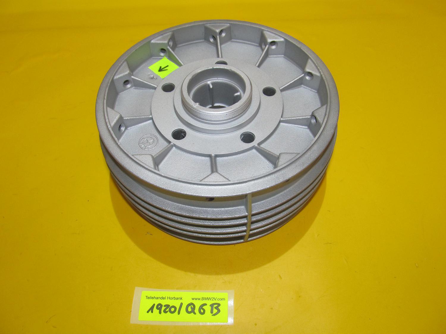

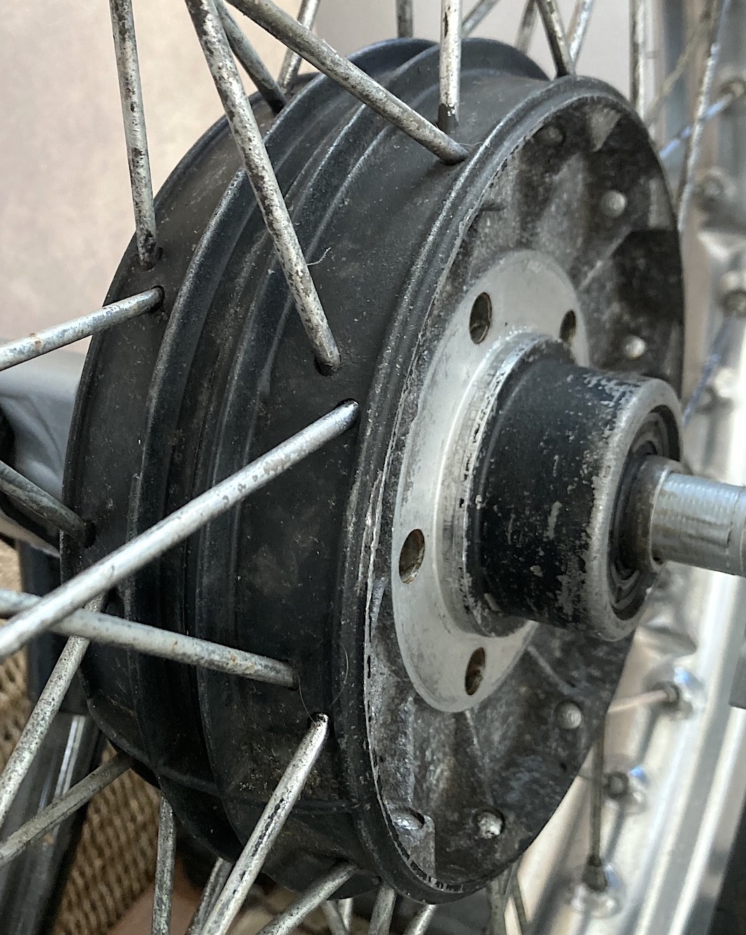

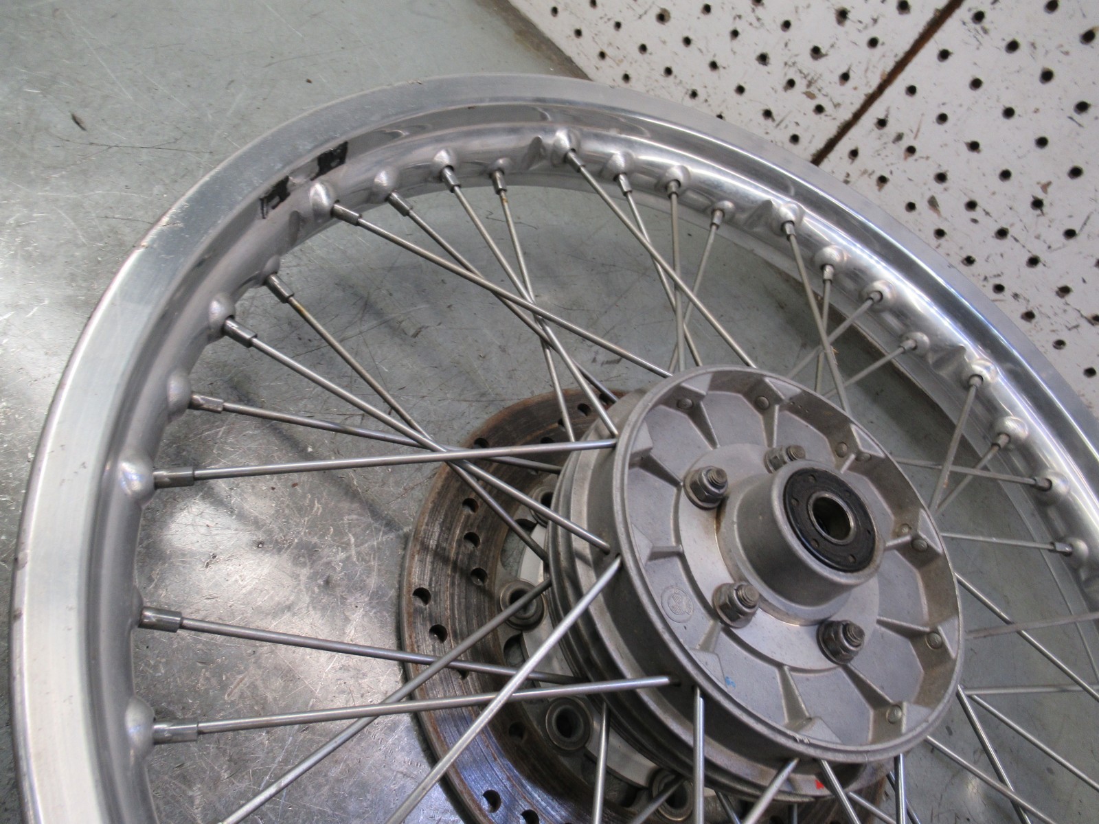

Seems I can only upload 3 images at a time. Here's the threaded 4 rib hub, an unthreaded two rib hub which came with a 19" rim, and an unthreaded three rib hub which, allegedly, is unique to R80ST. May be the two rib hub is unique to TIC models with Brembo brakes? (I don't know, no fiche, no manual says).
The 2, 3, and 4 rib hubs are all different thicknesses disc face to disc face, so must either have different dished discs which ... again ... isn't shown in the parts fiches!
The 2 rib measures up as 38mm.
From another forum;
The 3 rib measures up as 42mm
The 4 rib measures up as 52mm (possibly same as snowflakes)
Apparently there may be issues relating to spoke hole alignment if swopping from 19" to 18" ... so more joy working that out!
