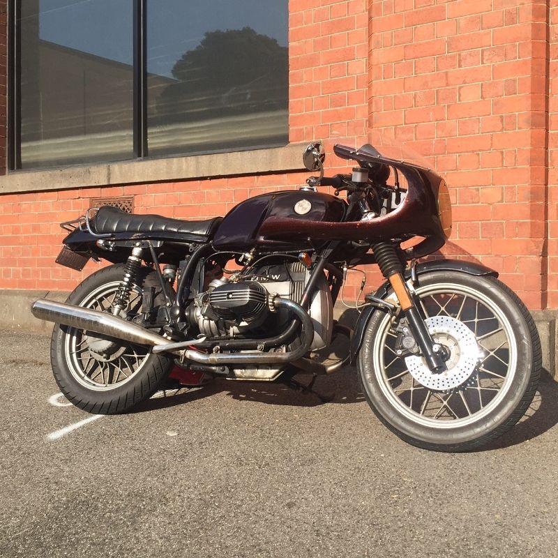

Hey guys - thanks for the in depth responses.
It's a '81 RT.. pretty original, not a bitsa. It idles well and quiet. This noise happened suddenly, not gradually.
After I heard it I decided to ride up and down the street slowly. It seems under load the noise is enhanced from a loud tappet like noise to something a lot more metallic.. then the power is also affected.. even without adding much load I can tell it isn't happy.
I'm dropping it to BM motorcycles in Ringwood (Vic) on Friday for a diagnosis. I have no problem pulling the engine apart as I have done it many times on my VW fastback.. similar engines.
I'd rather a professional ear hear it before I do the labour - hence the diagnosis booking.
Will let you know what it is and get some advice on the next steps.

Bike looks very sleek and nimble, Salty. BTW, a mob of us Oz Boxerworkers get together for weekend tech sessions** at comfortable camping spots around Vic and NSW. Your attendance would be welcome - er, once you get your bike running happily. Details in the Motorcycling sub forum.
