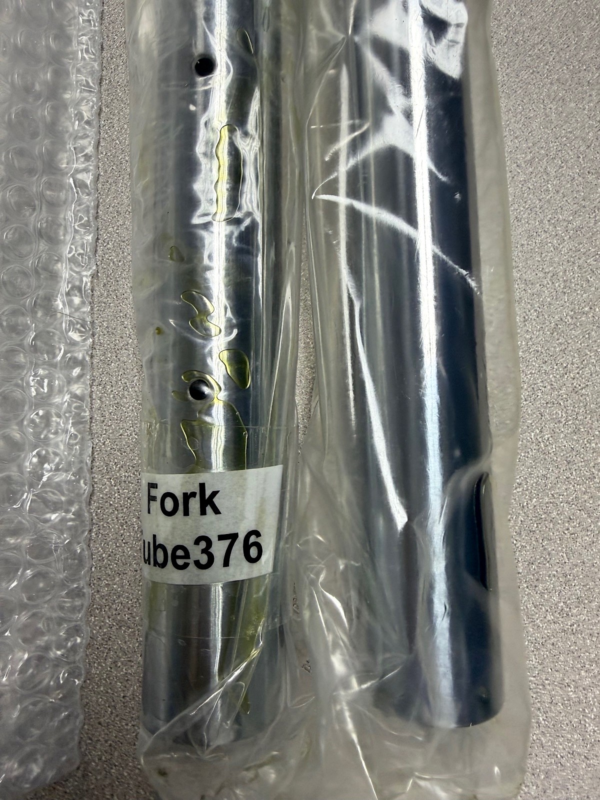

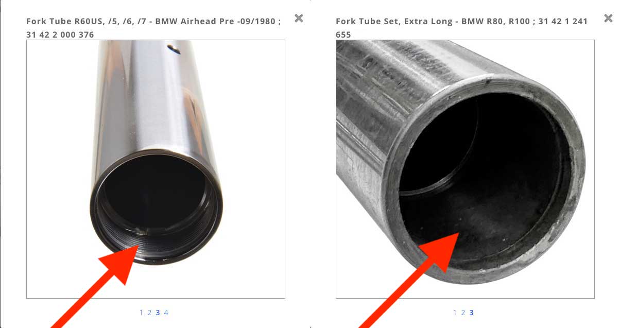

Is it that the earlier fork tubes have internal threads at both ends, and the dampening absorber has two washers and a spacer that screw into them and a circlip, whereas the later tubes don't and just use a push in unit and then the circlip?
(I haven't taken apart a later pair). See photos.
Neither types of stanchions have threads at the bottom... both types have threads at the top and use the same screw in top plug. The push in plug with a spring clip is ony used on machines that have a cast auminium top yoke. One of the few common parts is the threaded plug that screws into the top of the stanchion and locates it in the top yoke.
