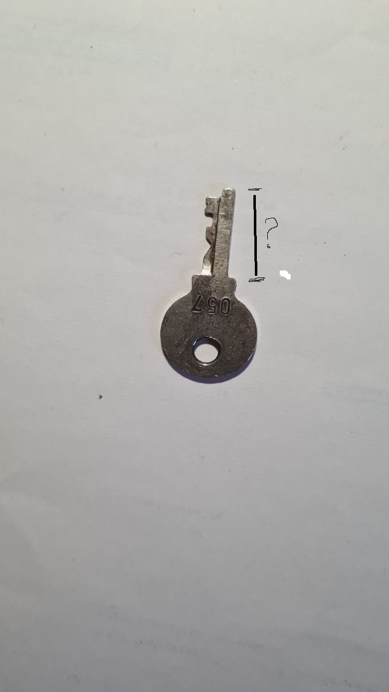

Would one of you be able to supply me with the dimension indicated in the attached?
My plan is to try and buy a blank from my local locksmith as a starting point and then start whittling away at it to match Rob's 057 photo in the hope that the tolerances are that slack they will make up for my amateurish attempts.

The length is 18mm. However, only the 5mm tip of the key enters the lock.
The rest of the keyway doesn't need shaping at all. Just the 5mm tip if you can find the correct profiled key blank.
I went to a local locksmith here, who is also a rider, and he couldn't find any blanks to match the three keys I presented to him. He showed me an internet thread discussing these keys where posters were asking for particular numbers. It was www.advrider.com
Key blanks that fit BMW airhead touring case locks.
I've found in my stash an Edmunds C10 key blank (made in Australia) that's been cut for an 065 lock. I don't have a 065 lock to check it. It's likely from 20-30years back. Also a Silca (Italy) HD1 for a 067.
So it's likely there are some blanks out there that have the correct profile to match. Just need to identify them.

I'm pleased to report I've had some success. A Yale ya27 blank from a locksmith had a similar profile to Rob's 057 key and after some grinding and filing I got it to open both a 057 and 054 lock. Unfortunately the width of the "tab" was a bit thin and snapped off! Fortunately you informed me only the first 5mm counts so I had enough of the key left to have another go. Out of 4x054 locks and 2x057 locks my second attempt fits 5 out of the 6. I'll take that for now.

as it's only the first 5mm that matters it'll be a much easier task to mill the profile. The blank can be made as a solid with the usual precut as that aspect is common to all keys. If it's some 3D print material it might be easy to do with due care.
Some of the keys are flat on one side too so even easier with just the one side to fiddle with.
I envisage having a blank on a drill press with the appropriate width bit and just mill the blank accordingly. Anyhow, that's a current thought. I have a bunch of small bits that should help. The square profile likely easy enough, but the triangular ones may provide another complication.
