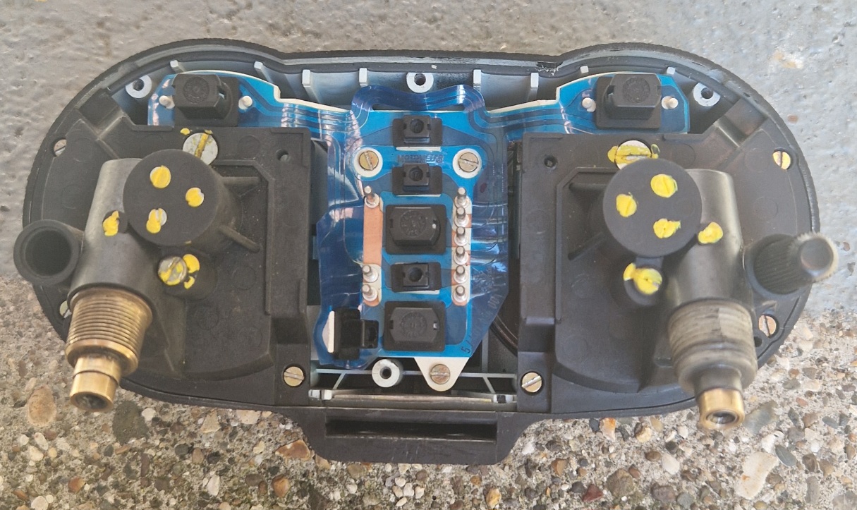

Also an image of the dash internals, it wouldn't let me add another to the previous post. It looks in good order, i can't see any faults.

As we look at the image above i identified the top left pin as 12v supply for.the warning lights and on the right,
3rd from top is gen lamp
5th is oil.
I used the corresponding holes in the connector for the tests in previous images

Measuring between the bulb terminals isn't really a good test, you get much more information by testing between the various points and ground. It is also important to carry out many tests with the load attached. If you work though the tests I suggested in the previous post you can be pretty sure to isolate the area of the fault.
