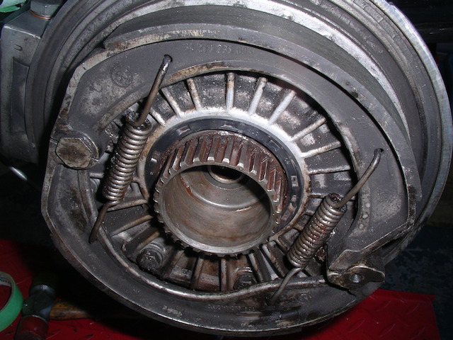

ME 109 wrote: Thu Apr 04, 2019 2:27 am 2mm is nothing regarding alignment. At present with the bigger top hat you have full contact. If you look at your fd splines you'll see a step in the splines from normal wear. That's ok.
With the big top hat left in place, there will be no difference in alignment between the two tyre sizes.
As mentioned it's just not a good mechanical situation to have all the torque going through a small contact area.
Most likely both the fd and wheel spline will yield until full contact is restored.
Good point! I would like to get back full contact with the rear brake shoes. The rear brake works fine as it is but better is better. You can see the two steps if you look closely.
IMGP0072 copy.JPG (123.62 KiB) Viewed 1221 times
Makes sense, I'll leave the spacer as is. The ridge left on my brake shoes; does that need an adjustment. My rear brake works OK, I just noticed that it doesn't use the entire surface. :ugeek:
