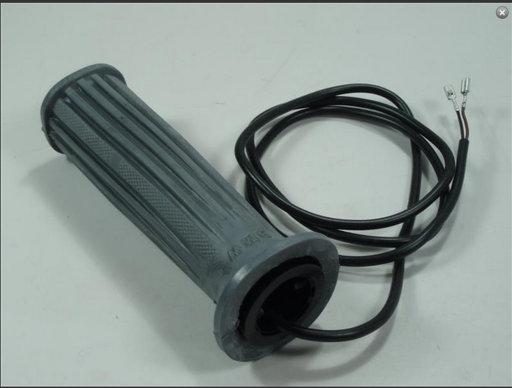

Not necessary in this case. the wire from each grip terminates in two female lucar connectors which push individually into the 4 way connector on the loom. It should be possible (corrosion and age permitting) to simply pull these from the connector and simply thread them through the bars... the individual lucar connectors should fit quite easily through the hole in the handlbars no need for any cut wires or removing wires from multiplugs...
Heated grip.jpg (71.44 KiB) Viewed 2124 times
Of coiurse, this assumes that the wiring on the bike and the handlebars are stock...
