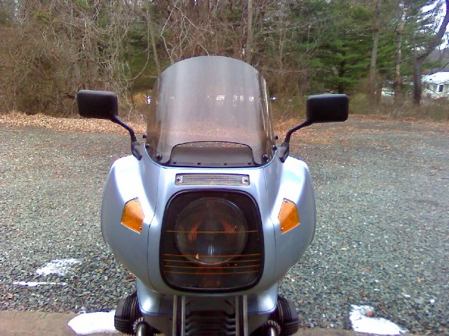

I bought a second pair of OEM mounts and drilled them out for a pair of NLA Napoleon mirrors.
Should have lubricated more while I was drilling as it heated the metal enough to spin in the plastic mount. Put a nut under it.
Done again, I'd due it more slowly with oil cooling. Then tap it with the appropriate threads.
77rs mirror1a.jpg (96.81 KiB) Viewed 953 times
